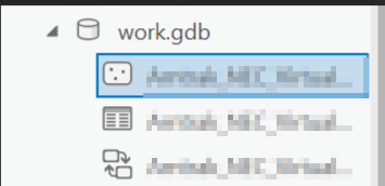

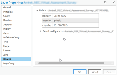

AndresCastillo
MVP Alum
If you take the portal item layer url.
login to the portal and set it as active portal in pro.
bring in the layer using the item id.
export the features, enabling the environments (Maintain Attachments, and Preserve Global IDs) as below:
The export will create the relationship class with all the needed pictures assigned to the respective records.
