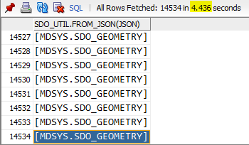

Downside: I tested it on a FC with 15,000 features and it was slower than I'd hoped.
I stored the JSON representation of the SDO_GEOMETRY in a text field in the FC. And then converted it to SDO_GEOMETRY on-the-fly in a query using sdo_util.from_json(). Unfortunately, it still took 4.5 seconds to run the query on all features. I was hoping it would be closer to 1 second, which is how long it takes to select a true pre-computed shape column from a table.
alter table atn_json_text add json nclob invisible; --ArcGIS uses NCLOB for large text columns, so that's what I did too: https://desktop.arcgis.com/en/arcmap/latest/manage-data/gdbs-in-oracle/data-types-oracle.htm#:~:text...
update atn_json_text
set json = sdo_util.to_json(wkt_lrs(sde.st_astext(shape),sde.st_srid(shape))); --wkt_lrs is a custom function: https://i.stack.imgur.com/dOfPg.png source: https://gis.stackexchange.com/a/428825/62572
commit;
select sdo_util.from_json(json) from atn_json_text;
