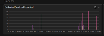

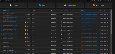

I have an issue with my services constantly timing out and users are saying it is acting very slow and freezing. I have monitor and this is what I was receiving below. The Water Group was set to dedicated instance and now I am wondering if it should be shared. If this doesn't get fixed the users will stop using the programs. I am not an expert on this subject so any ideas to get this working is much appreciated.

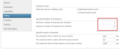

In ArcGIS Server Manager, check the min/max instances of your service:

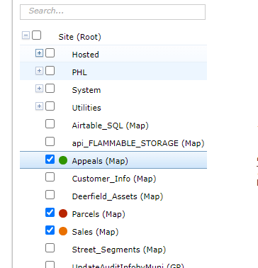

Click on any of the graphs below.  Uncheck Site on the left, and select the service(s) in question:

If you see the max instances of the service(s) are being used, this is an indication that you need to increase the max amount.

For some reason it is not letting me check any boxes.

I can only select one at a time and when I switch the show to something else the graph doesn't actually change. I tried on 2 browsers.

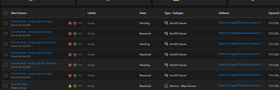

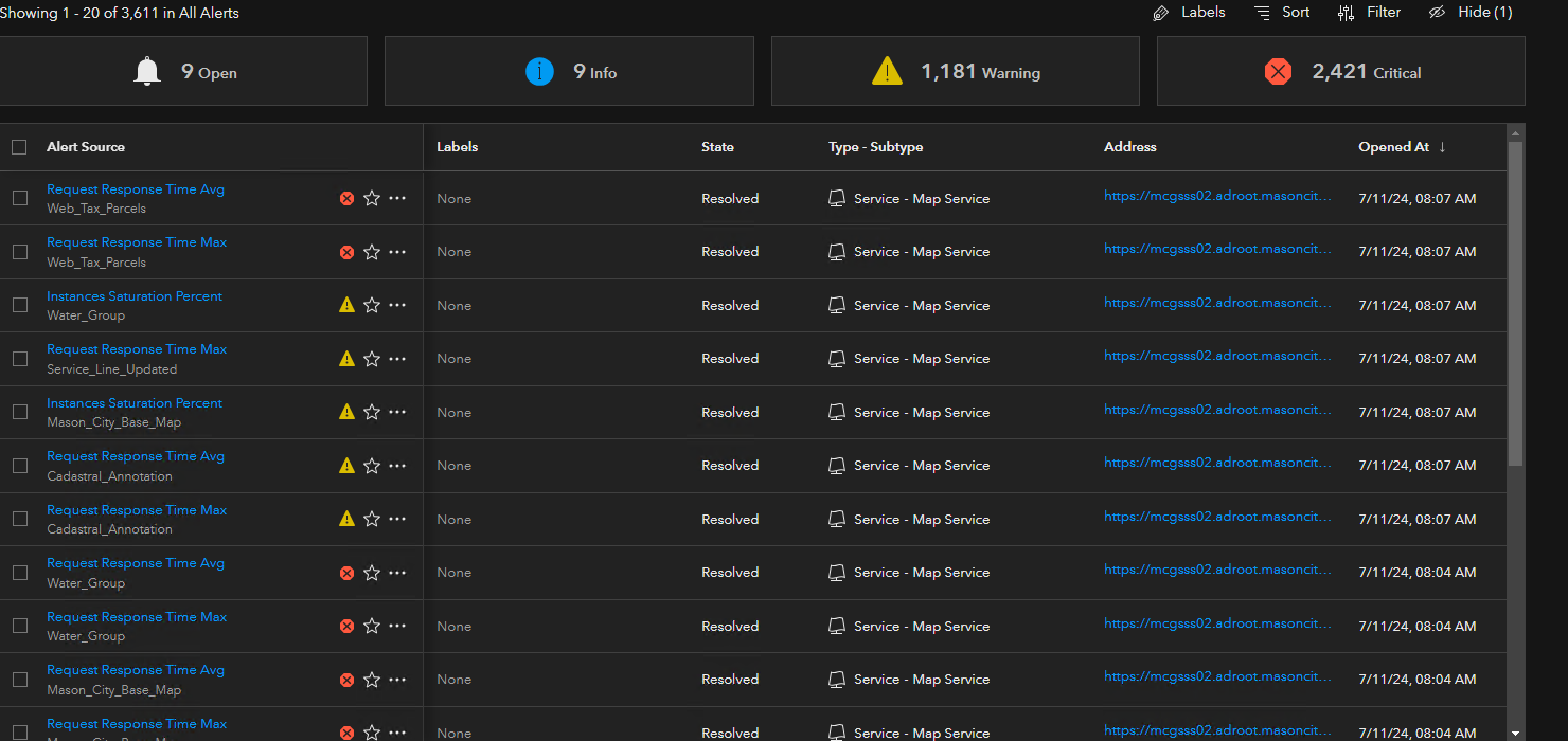

Finally worked must just be really really slow..? Not sure if these errors have anything to do with it.
