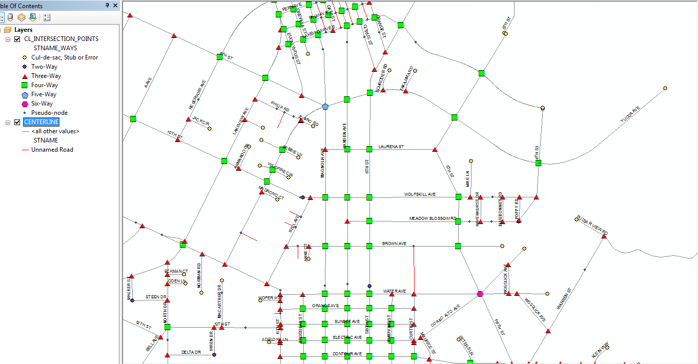

Here is a picture of what the field data looks like for the code as written:
OBJECTID *Shape *STNAMESX_COORDY_COORDLINK_X_YWAYS_COUNTSTNAME_WAYS
50676Point{MADRONO CT}6296418.9044142243614.433358{6296418.9044}{2243614.4334}1{1}
50867Point{10TH ST}6297064.905092243667.729839{6297064.9051}{2243667.7298}2{2}
50889Point{10TH ST}{WOLFSKILL AVE}6297145.8704792243668.425376{6297145.8705}{2243668.4254}2{1}{1}
50997Point{BELL AVE}{WOLFSKILL AVE}6297360.5655882243670.268876{6297360.5656}{2243670.2689}3{1}{2}
51160Point{MAGNOLIA AVE}{WOLFSKILL AVE}6297781.1530022243671.327601{6297781.1530}{2243671.3276}4{2}{2}
51407Point{HANSEN AVE}{WOLFSKILL AVE}6298405.941452243672.728517{6298405.9415}{2243672.7285}4{2}{2}
51724Point{6TH ST}{WOLFSKILL AVE}6299040.4175432243674.151414{6299040.4175}{2243674.1514}4{2}{2}
52871Point{5TH ST}{WOLFSKILL AVE}6301563.8219452243679.94635{6301563.8219}{2243679.9464}4{2}{2}
53020Point{MIKE LN}{WOLFSKILL AVE}6301904.8921292243680.73211{6301904.8921}{2243680.7321}3{1}{2}
53164Point{HAVENHURST DR}{WOLFSKILL AVE}6302189.4184632243681.387948{6302189.4185}{2243681.3879}3{1}{2}
53355Point{WOLFSKILL AVE}6302528.1103712243682.16813{6302528.1104}{2243682.1681}2{2}
53469Point{BLUEBONNET RD}{WOLFSKILL AVE}6302822.6678532243682.846935{6302822.6679}{2243682.8469}3{1}{2}
53637Point{POPPY RD}{WOLFSKILL AVE}6303293.8063462243683.932563{6303293.8063}{2243683.9326}3{1}{2}
53810Point{4TH ST}{CORSO ALTO AVE}{WOLFSKILL AVE}6303774.8463952243684.940106{6303774.8464}{2243684.9401}3{1}{1}{1}
50553Point{MADRONO CT}{YUCCA AVE}6295970.8866092243832.745913{6295970.8866}{2243832.7459}3{1}{2}
50586Point{10TH ST}{YUCCA AVE}6296116.8820522244123.025844{6296116.8821}{2244123.0258}4{2}{2}
50779Point{WILDFIRE CIR}6296733.2518822244238.88388{6296733.2519}{2244238.8839}1{1}
50638Point{WILDFIRE CIR}{YUCCA AVE}6296284.7898532244458.484163{6296284.7899}{2244458.4842}4{2}{2}
50332Point{10TH ST}{ARMANDO DR}6295320.5243932244504.723572{6295320.5244}{2244504.7236}3{2}{1}
50534Point{WILDFIRE CIR}6295917.8335652244566.072531{6295917.8336}{2244566.0725}1{1}
53872Point{YUCCA AVE}6303868.6926642244646.38405{6303868.6927}{2244646.3840}2{2}
53854Point{4TH ST}{YUCCA AVE}6303843.8856272244649.336472{6303843.8856}{2244649.3365}4{2}{2}
50223Point{10TH ST}{LAKEVIEW AVE}6294916.129862244698.551596{6294916.1299}{2244698.5516}4{2}{2}
53027Point{MIKE LN}6301917.137842244702.955131{6301917.1378}{2244702.9551}1{1}
50855Point{DEBBIE LN}6297012.3366262244807.570407{6297012.3366}{2244807.5704}1{1}
50737Point{DEBBIE LN}{WOLFGRAM DR}{YUCCA AVE}6296566.1331222245018.051942{6296566.1331}{2245018.0519}4{1}{1}{2}
Here is a picture of  one of the ways this data can displayed:
