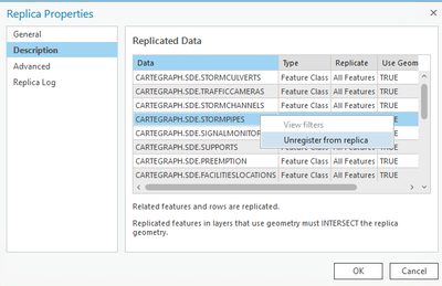

It is possible to drop a feature class from an existing replica using the Replica Properties menu (see screenshot), but there isn't an easy way to add a feature class back in. Personally, I wouldn't recommend dropping a feature class from a replica this way unless you have a good reason for doing so.

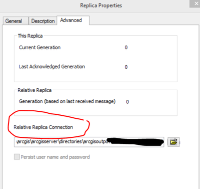

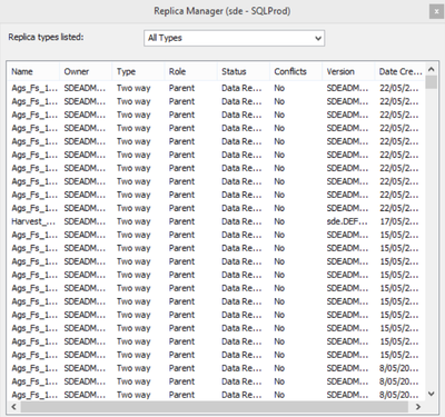

I decided to unregister the feature class from the replica in the child and parent geodatabases,  but I am not able to see it in the child geodatabase. The replica manager shows hundreds of replicas (not the default version), and the connection to the arcgis server is listed in the properties section. What does this mean?
