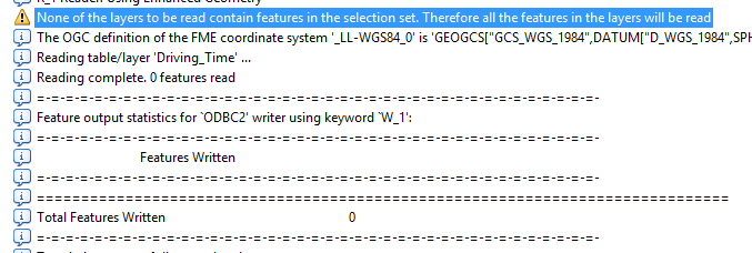

I'm having an issue using the Quick Export feature to our enterprise database.  In the past I have used quick export to write point features to our database without any issues.  For this task, I am trying to write out line features to the same database.  The connection is good but I am seeing a strange warning message in the results:
Has anyone seen this message before?  What should I do to correct this?

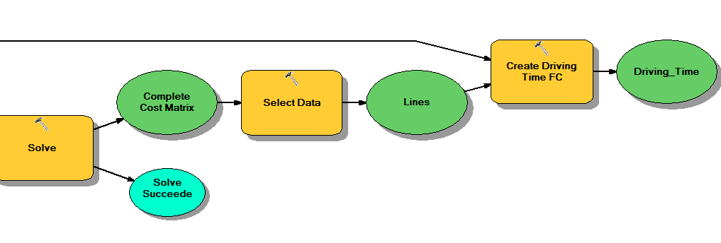

This particular line feature is created using an OD Cost Matrix using model builder.  Here is the output portion of that model:
If I need to adjust how my model is creating the feature class, I can do that, as my end goal is to export this data correctly to the database.

Jim, why use Quick Export?  You can use Copy Features or Feature Class to Feature Class.
I have seen the warning you're seeing in Spatial ETL tools and as far as I know it is meaningless.

Hi Bruce, Good question.  Those functions do not work with PDA (Netezza).  They do work just fine going to SQL server but unfortunately I need to send this information over to Netezza.  I'm not really concerned about the warning, but the fact that 0 features were written is the real issue here.  It's weird how this works perfectly with point features but no line features.

Ah I see.  If you are embedding Quick Export in a Model it will try and inherit the GP environment and there may be a bug in this.  Log a support call.  Try adding a selection step in your model (make layer, select by attributes) or create a Spatial ETL tool that takes the output from Select Data and writes to Netezza.
