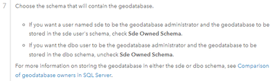

In SQL Server there are 2 options to create the ArcSDE repository, 1) dbo owned or 2) sde user owned.
Create a geodatabase in SQL Server—ArcGIS Pro | Documentation
I tell all my customers to not use DBO, it does not provide the level of security for your data that is necessary, and instead always use the ArcSDE Repository with the sde user owner.
