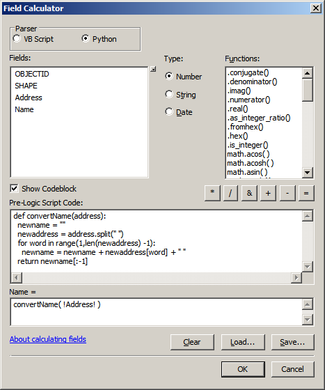

I had more of a thought about this and to make it more robust it would be better to use the following python snippet:
def convertName(address):
  newname = ""
  newaddress = address.split(" ")
  for word in range(1,len(newaddress) -1):
    newname = newname + newaddress[word] + " "
  return newname[:-1]
to use in the field calculator follow the screenshot:
  newname = ""
  return newname[:-1]
StevenHeadley
Thanks Anthony! I know very little about scripting, but this was great. Just saved me tons of time.
