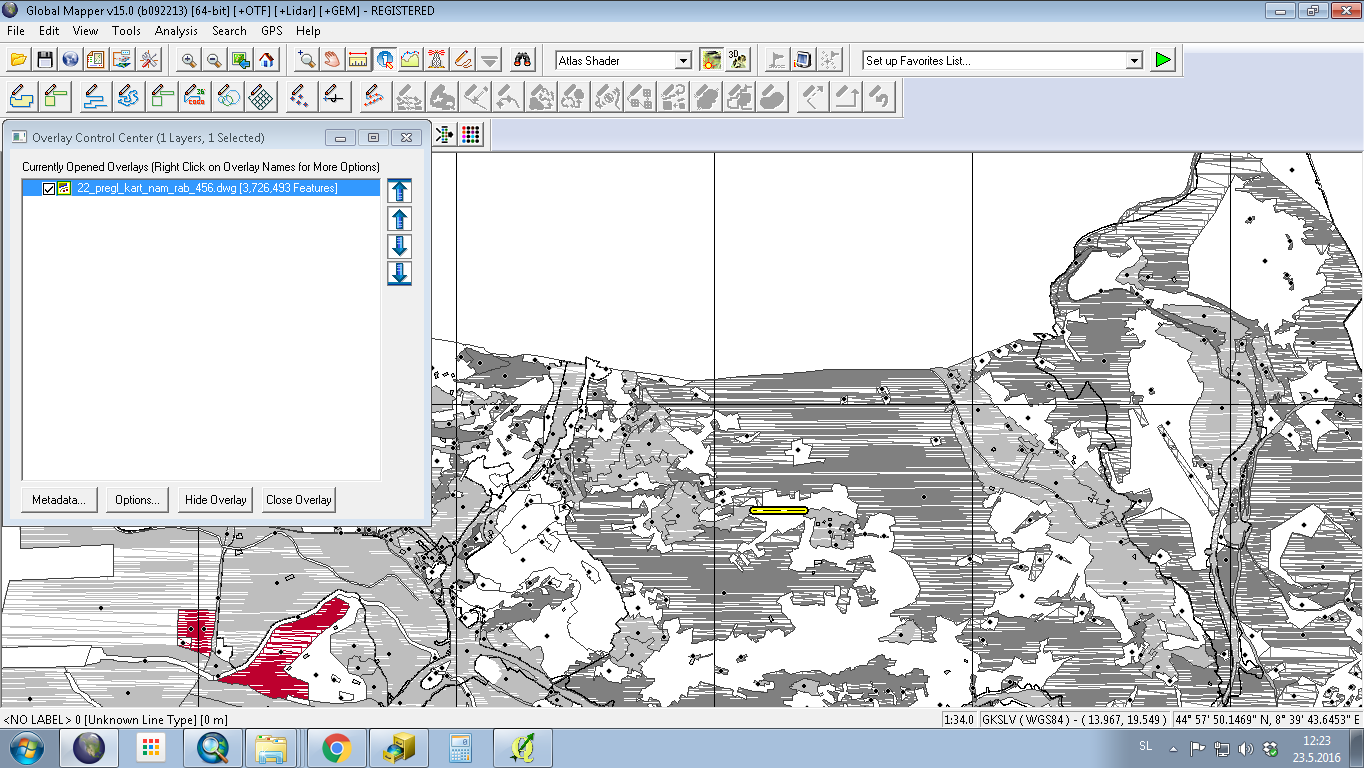

I need an advice about opening DWG file in ArcMap 10.0
since now I didn't have problems opening DWG files, but now I received a DWG file that doen't open in ArcGis.
I tried to convert it with multiple converters - Teigha, ReaConverter with no success.
The problem is, that DWG consist of lines - please see picture below, I can't explain it. (picture is taken from Global Mapper).
As you see there aren't polygons as they should be to import DWG to ArcMap.
Where is the problem? In AutoCAD export settings?
Thank you, Sonja.

that looks like it wasn't properly created/exported

The issue I often see is that the polygons are not "closed" in CAD. When they aren't closed (as shapes), they do not come in as polygons. Can you verify that these areas are closed and denoted as "complex shapes" (I believe that is the terminology that is used in AutoCAD)?
Another question, was this CAD data always in AutoCAD? Or was it in another CAD program, then moved to AutoCAD? I find that this conversion can sometimes blow up the polygons as well, for some reason.

I am not familiar with Global Mapper, but I think that you should to export your DWG file in 2004 format to make sure that will not cause any problem.
If you don't see polygons , then you should to open DWG file in AutoCAD program and make all layer open ( all light is open) and save the file before close.
