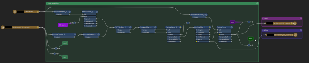

forestknutsen1
MVP Alum
I just recently did a project like this between a customer information system and GIS using FME. I used the CRC Calculator for change detection and then deleted, inserted, and updated my target feature class in GIS. Then I set the FME workspace up as job on a server that runs every night.
https://docs.safe.com/fme/html/FME-Form-Documentation/FME-Transformers/Transformers/crccalculator.ht...
In another project, with Cityworks and GIS, I kept the only the spatial data in GIS and then joined the attribute data with a Oracle database link to the non-spatial system. This worked okay too, but it is a little show and clunky to work with.
SouthCoastGIS
Great to hear you have used this method before, I am thinking of going the change detection route for speed rather than the overhead from a joined table.
What was behind your decision for using the CRC calculator rather than just the general ChangeDetector transformer in FME?
forestknutsen1
MVP Alum
I did try the ChangeDetector but it was a little bit unstable and slow with my data.
https://docs.safe.com/fme/2021.2/html/FME_Desktop_Documentation/FME_Transformers/Transformers/change...
So, in the end I went with the CRC calculator. I did have to sacrifice updates on my main target table (I have a few derivative tables that do get updates basted on the output of other transformers). So, if there was any change in a row it just deletes it and then inserts it back.
