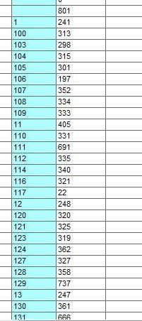

Hi everyone,
I just need help in one of my field...ive already input the numbers in my field but they are not coming serially even though i put them in ascending order instead of showing 1..2..3 etc the numbering shows as 1..100..102..2 etc can u help me so that the numbers come in ascending order..i hope u get my point..thank youNUMBERING.JPGNUMBERING.JPG

It is called a "natural sort"
Migration from ArcMap to ArcGIS Pro for data validation—ArcGIS Pro | Documentation provides some coding options.
In the future if you want to use "text" numbers, you can pre-pend 0's
0001
0011
0111
1111
If you don't want them be in text format, which they currently are, you will have to add a new integer field (short or long) and recalculate the values into it using
int(!YourFieldName!)
then use that field for sorting.
