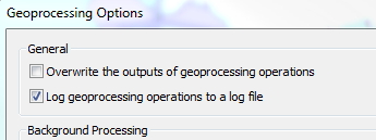

You can see I do have that box checked in geoprocessing options:

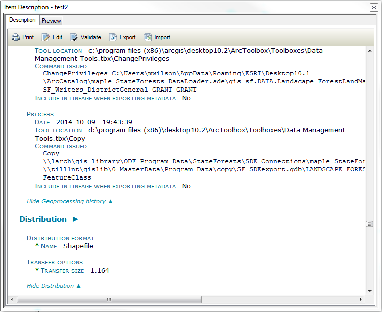

I performed a test, a simple export of an FC to a shapefile, just now. Here is the item description window for the output, showing results only up to October of last year:
Do you see what I'm saying? I'm wondering if there is some kind of limit on the length of the geoprocessing history.

Ok, I upgraded to the ArcGIS Metadata for this test layer. No dice. Same result after I exported the file again:

hmmmm what does the
Include in lineage when exporting metadata  No
line mean?  Should this be Yes if you want it to be included for future reference? Does that mean that it won't be included.  I guess there must be some place that you can toggle it on and off .  I wonder if the history does get exported when you make copies via exporting...I can't check since I don't have any files that are over a year old that I have done 'stuff' to.
SepheFox
Deactivated User
I don't know, but it's not editable, at least in the metadata. For the edification of all, I did a clip operation on my test file. Results still stop at that last 2014-10-09 process in the resulting feature class.
Are you sure you don't have metadata over a year old? The geprocessing history carries forward from the original layers, which incidentally seems like part of the problem. Perhaps the Geoprocessing history can only be so long? You would think, if that was the case, it would delete the older entries first.  No one needs a record of all the permission changes that happened to the SDE version over the years.
