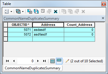

If you are using the Field Calculator in ArcMap, you can select the records = to 0 and just calculate the value to NULL
For instance:
