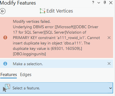

When someone edits/create a feature in actual Feature class which was enabled with Version (traditional) options, the global Id's in delta tables are with 0's as shown in figure. How to get red of those? is there any configurations required to avoid this ? triggers are enabled on delta tables

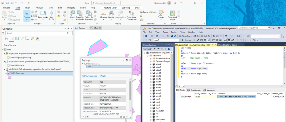

@vijaybadugu I saved my edits, and I checked the Adds Table of the Featureclass and the Global ID was populated correctly.
| Pro 3.3.0 | SQL Server 2019 CU 25 | ArcSDE Repo 11.3.0.3.3 |
If you continue to experience an issue, then open a ticket with Esri Support and provide a copy of your ArcSDE Geodatabase for support to try to reproduce.

We are getting this error while editing/creating feature with globalids as 00000000 . we are updating one of the attributes Acres through trigger on delta tables (A Table). do we need to update global id too ?
