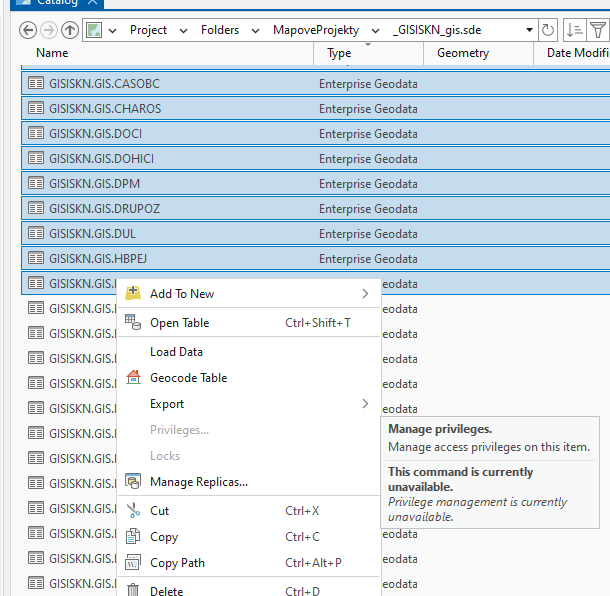

I would like to switch all work from desktop to ArcGis Pro, but even after 3.6.0 update we are not able to manage privileges for more than 1 item, and i am not gonna change it one by one for more than 100 items (again 😞 )
