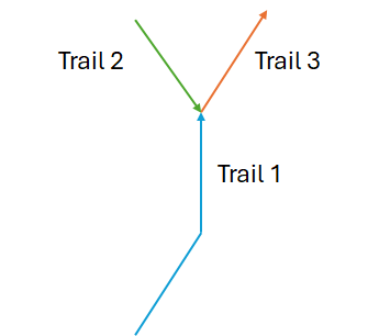

RobertKrisher
The above script is pretty good, although there are a few issues you'll need to adjust to suit your data. Consider this crudely drawn example:
  • Instead of using the entire trail line you will likely need to break each line into multiple segments, so you only consider the angles of the line segments that intersect each other.
  • The orientation of these line segments may not always be consistent, you may need to periodically flip the orientation of a segment when doing your calculation.
If you found all the locations where trails intersected, buffered those points out slightly, and calculated the angle of each line intersection that would solve most of these issues. You would just need to flip the angle of the line that represents the angle of travel.
