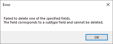

so we want to remove a subtype from a field and create a new field with a domain that has the same values we use in the subtyped field.  I used the remove subtype geoprocessing tool,it seemed to worked fine.  I create a new field and calculated the values from the old subtyped field over, all is well.  I am trying to delete the old field now and am unable to do it.  Does anybody know how to do it, if even possible?  Thanks for any advice!

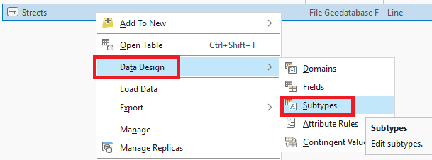

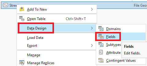

@ScottFortman1 - here is how to delete the Subtype field in ArcGIS Pro.
These steps should have worked for you in Pro as well.

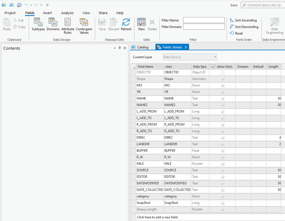

ArcGIS Pro 3.2.2 > Data Design > Fields
"Delete" is disabled for the *Subtype field.
Workaround

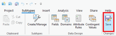

ArcGIS Pro 3.2.2 > Data Design > Subtypes
Subtypes > Create/Manage
Subtype Field: <Clear all subtypes...>
Click OK
Click Save
Close the Subtypes tab

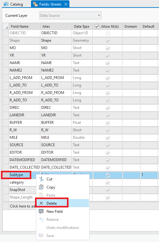

Open the Fields tab
select the Subtype field > right click > choose delete
Click Save
The Subtype field was removed.

@ScottFortman1 - ArcGIS Pro will not let you delete the *Subtype field, that is expected behavior.
You will need to create a new empty Featureclass with the new fields and domains that you want then you will reload the data using the old Featureclass.

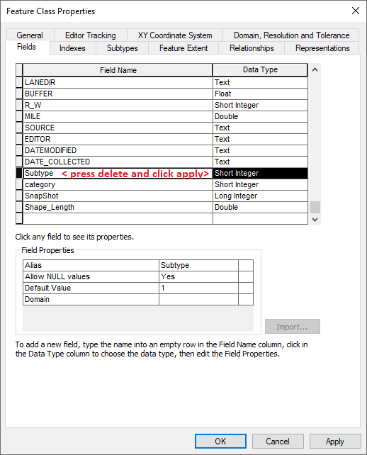

Ok thanks.  Just to try it, I did try this in ArcCatalog (10.8.1) and was able to delete the field there.

ArcCatalog 10.8.2 cannot delete the *Subtype field. But if we go to the "Subtypes" tab and set to <None> then under the "Fields" tab will be able to delete the Subtype field.
Workaround

Yes, that is exactly what I did.  It would be great if there was a way do that in Pro.  Thanks for clarifying the solution for others who view this.
Workaround
Click OK
Click Save
Open the Fields tab
Click Save
