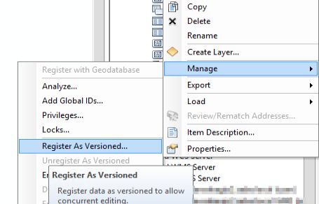

On our ArcGIS 10.7.1, we tried to unregister a Feature Class as not longer versioned. After this was done, we are unable to open the Feature Class:
The item does not have a definition
We are also not able to re-register the Feature Class as versioned, again:
Cannot register as versioned
Our database is a Microsoft SQL Server 2016 SP2.
We also tried to delete the Feature Class, which gave the below error:
Cannot delete. The item does not have a definition.
Any idea, of how we can get this Feature Class removed, so we can re-create it?
