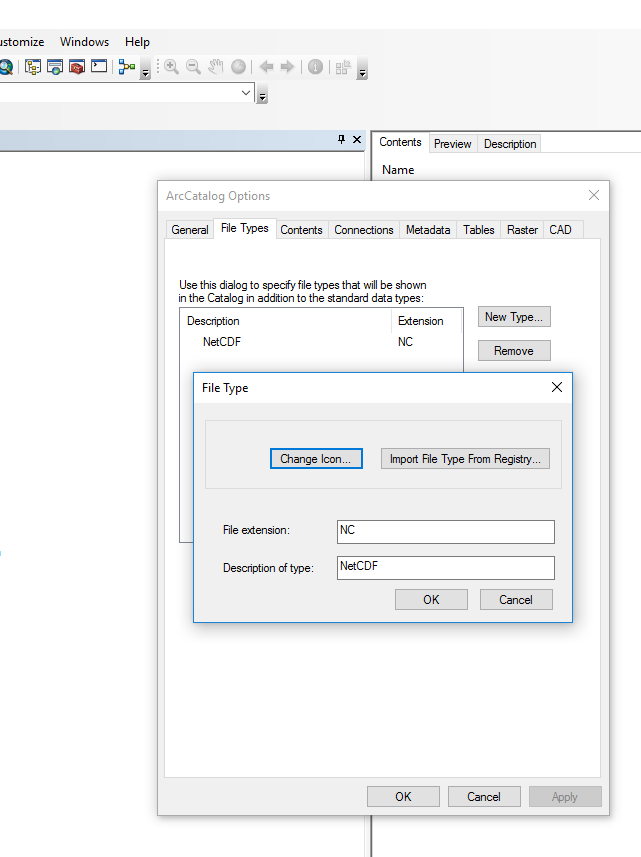

I want to add the .nc extension to the ArcCatalog file extension options, so that I can drag and drop .nc files from ArcCatalog. I succesfully added the extension in ArcCatalog 10.4 (Win 8.1 OS) but it doesn't seem to work for ArcCatalog 10.5 (on Win 10 OS): I added the .nc extension as displayed below (already tried with various formats - .nc, .NC, nc, NC...), even restarted the system, but .nc files are still not visible from neither ArcCatalog nor ArcMap. Any help is greatly appreciated.

Yes!! As stated in my first post, that's exactly what I have done, as it is also shown in the ancillary picture (ArcCatalog > Options > File Types)  and in my previous link. But unfortunately it doesn't  work for me in ArcCatalog 10.5 under Windows 10 (although, I reiterate, it does in v. 10.4)

Thanks for the suggestion Dan. I did it indeed, and in fact I can see .nc files in windows explorer whit the arcCatalog Icon, but still cannot see them in arcCatalog tree. Not sure how to use the 'import file type from registry' option as in my window I can only see a limited list of file types (see picture) and do not know how/if possible to extend this list to include nc extension
