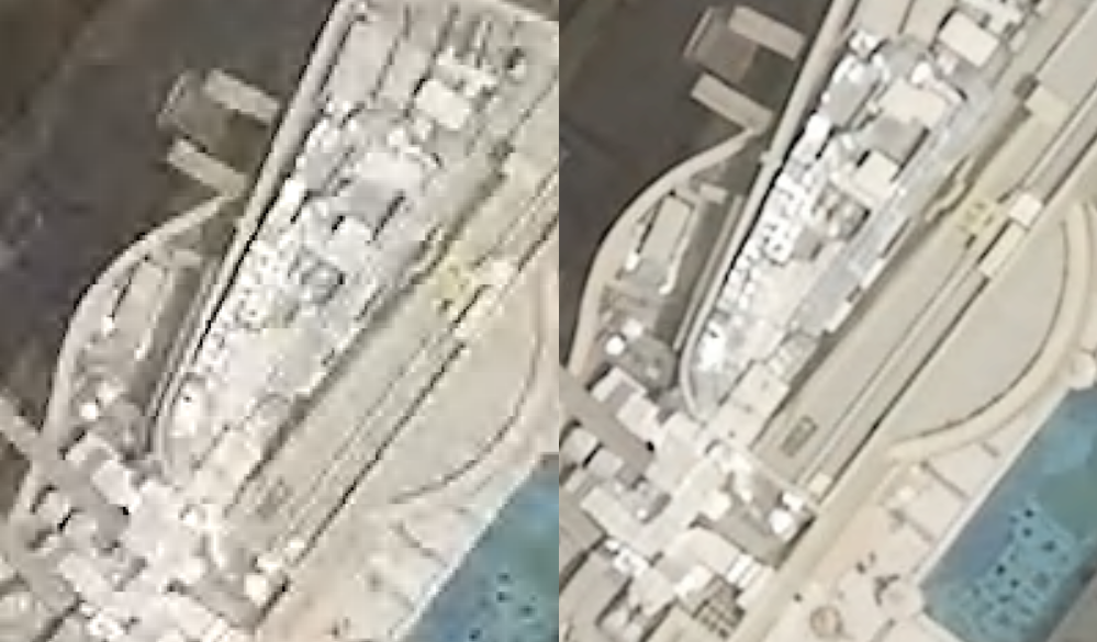

MrSID vs JPEG2000: Why GIS Professionals Prefer MrSID. Real Compression Test Results That Set the Record Straight
Original GeoTiff: 1.06 GB
100:1 Compressed JPEG2000: 5.6 MB
100:1 Compressed MrSID: 1.6 MBCombined.png
