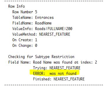

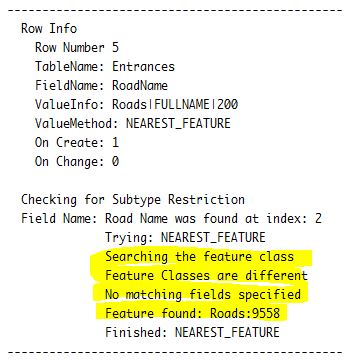

I am using the Attribute Assistant to try and auto-populate a field.  I am trying to grab the nearest road name within 200 feet of a created point.  The rule I have written in the DynamicValue table works, but only when I seem to have a limited number of features/layers within the map document.  If I have just the point feature, the road layer and the DynamicValue table within my map document, the rule works as expected.  However, if I start adding layers to ArcMap, it doesn't seem to work anymore.
Below are the screenshots of the AttributeAssistant log file after a successful run and an unsuccessful run.  All I have done to the map document is add layers between the successful and unsuccessful run.  I have not altered the source data.
Anyone have any ideas why it can't find the Roads feature class when failing?
Success
Error
MikeMillerGIS
Esri Frequent Contributor
Matt,
  The error means it cannot find the layer.  I fixed the section to be more descriptive.
