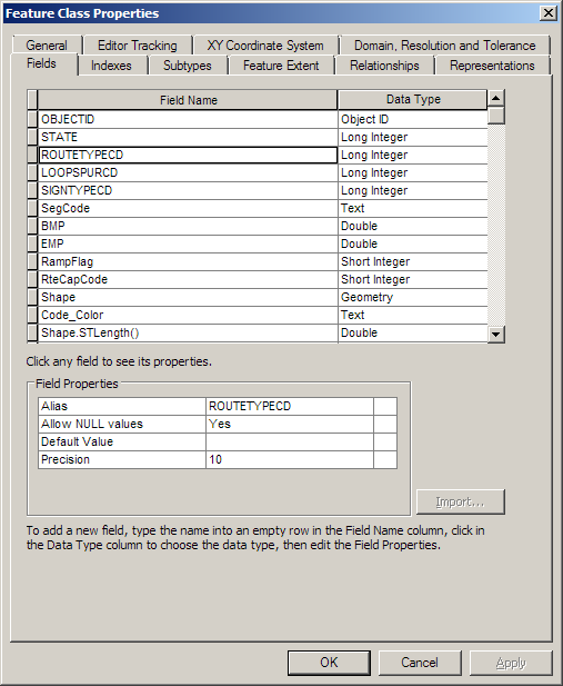

Why am I not able to add a domain to a long integer field of a feature class in a SQL SDE database? In ArcCatalog I click on a long integer field and I do not have the option to set a domain. I can add a domain with this same feature class that has been copied to a file geodatabase.
Anyone have any suggestions or pointers what I may be doing wrong?

Do you actually have a domain created in your geodatabase that is for a Long Integer field type? I was able to replicate this issue from a quick test on a file geodatabase. Once I created a domain with a Long Int field type, I was able to assign it to the Long Int field.
MichaelMiller2
Blake,
You nailed it!  It works now.
