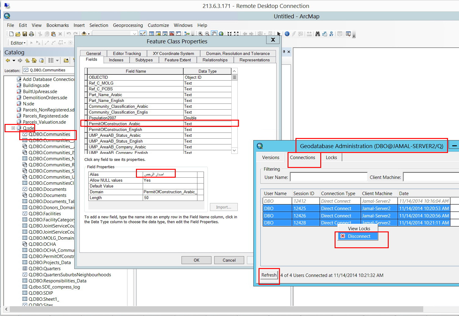

I couldn’t figure out if there is a robust technique by which editing the properties of the enterprise geodatabase, enterprise feature class or enterprise table can be done easily.
At the moment, I used to “disconnect” users in order to be able to do the editing. This is a very exhaustive approach as sometime, and after doing the edits, they are not taken by the system.
Which approach do we still have to apply the edits easily?

Changing the datamodel while people are accessing the data can lead to unpredictive results. Therefore ArcCatalog places a lock while the table/feature class is used.
The most robust approach: think, rethink and then create and finalize the data model before using it in production. Changes can be made in a test environment and after testing deployed on the production environment in maintenance time (not during production hours).
Another note: all users are connected as schema-owner DBO. You can also create seperate users in the database and grant read/write privileges via roles to the users. Then you can identify who is locking the table and give him a call instead of disconnecting the user.

All what I wanted to do is to find easy way to do some editing on the properties of the enterprise geodatabase\ enterprise feature class
I couldn’t figure out how to take the advantages of the connection\locks tabs to accomplish such task. All what they offer is “disconnecting user” and just after a second the enterprise environment get not-editable.
What might the “locks” tab indicate for? Can it be used to offer an easy environment to edit the properties of the enterprise geodatabase?
