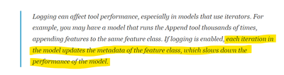

I realize now that I should have mentioned that we run our tool very frequently.  And I also wasn't aware of this hidden danger:
Inside of the GDB_Items table managed by SDE, there is a Documentation column containing an XML document that contains the history of geoprocessing operations performed on the feature class in question.  Every time our tool ran and appended rows, it added a block of logging XML to that feature class's history.  The XML document for that feature class had grown to over 45MB, making further logging updates painfully slow!
Here's an article that talks more about this:  Geoprocessing history logging in ArcGIS: performance review – Alex Tereshenkov (wordpress.com)
So the solution in our case is to turn this logging history off for our geoprocessing task, to ensure that we aren't writing geoprocessing operations to the dataset metadata.
