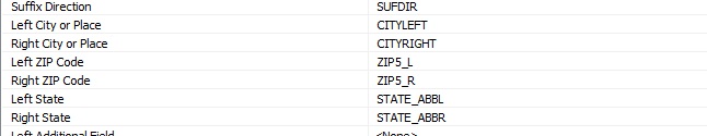

9. Select your customized style file. Make sure the city, state, and zip code fields have street data associated with them.

I wonder if the same sort of work around that I ended up with can be added here; add the zone fields to the data you are matching to but calculate the values to empty.  ( "" doublequote doublequote instead of null.)  Might be worth a shot.
