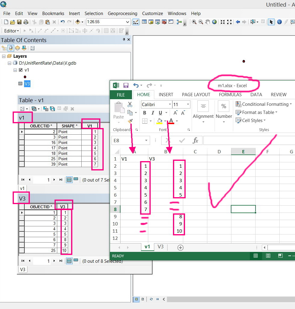

In the screenshot below, I wanted to combine V1 and V3 tables based on V1 and V3 fields and to have the result as shown in the excel file (in the same screenshot).
How this might be performed?
Thank you

from here Joining attributes in one table to another—Help | ArcGIS for Desktop
this is the default behaviour
When joining tables, the default option is to keep all records. If a record in the target table doesn't have a match in the join table, that record is given null values for all the fields being appended into the target table from the join table.Example of keeping all records with a join
whether using the Add Join tool in
DesktopAdd Join—Help | ArcGIS for Desktop
Pro Add Join—Data Management toolbox | ArcGIS for Desktop
so if the join doesn't work one way, switch the direction of the join.  If you don't like it that way, save the joined file as a separate file and join it back to the file you want the join to go to.

Thanks Dan,
I’m aware of using multiple tools to do this sort of work. However, my intent is to find one single tool that can do the job.

There isn't one, just the join and the results are directional, and you would have to create a model (or a script) to emulate the workflow that I suggest should the intended results not be to your satisfaction or expectations.
