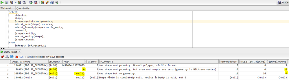

@VinceAngelo To clarify:
I think I understand your point about Nil geometry (row #2 below).
However, I'm referring to cases where the geometry is truly null/no value (row #3 below).
select
    objectid,
    shape,
    (shape).points as geometry,
    sde.st_area(shape) as area,
    sde.st_isempty(shape) as is_empty,
    comment3,
    (shape).entity,
    sde.st_entity(shape),
    (shape).numpts
from
    infrastr.inf_record_sp
Let me know if I've misunderstood something.
VinceAngelo
I don't use regularly use SDE.ST_GEOMETRY.
How did you create those rows, because at least one of them seems malformed.
- V
Bud
Regarding,"How did you create those rows, because at least one of them seems malformed."
The features were all created using OOTB functionality in ArcMap or ArcGIS Pro. We don't create features using code (Python, SQL, etc.). Beyond that, I don't have information about how specific features were formed.

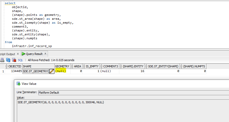

A follow-up point regarding the original idea: The ST_GEOMETRY db datatype allows a feature to be constructed with a null geometry using SQL:
insert into infrastr.inf_record_sp (objectid, shape) values (
    sde.gdb_util.next_rowid('MY_OWNER', 'MY_TABLE'),                     --objectid
    sde.st_geometry(16, 0, 0, 0, 0, 0, 0, 0, 0, 0, 0, 0, 300046, null)); --shape
commit;
I can query the new row to see what it looks like. It is in state #3 (geometry is null).
To me, the ST_GEOMETRY db datatype should not allow a feature to be constructed with a null geometry using SQL. Maybe that's a bug.
I wonder if there should be a constraint: If the shape is not null, then don't allow the geometry to be null when creating features.
