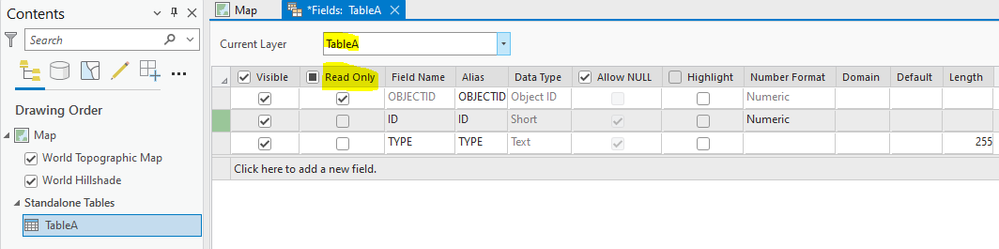

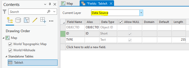

If I understand correctly, it's possible to set a field as read-only in the map Contents layer properties.
But it's not possible to set a field as read-only in the feature class source properties in the geodatabase.
It would be helpful if we could set fields to read-only right in the FC source.
I'm aware that we can do something similar using attribute rules. But that requires custom code, adding complexity to an already heavily customized system. To me, it would be better if we could do it using OOTB functionality in the FC source properties.
