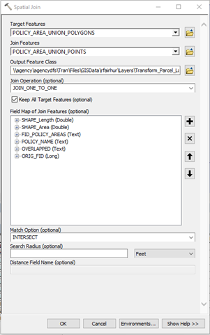

  6. Run the Spatial Join tool in the Analysis toolbox under the Overlay toolset with the following settings:
    1. Make the Feature to Polygon output the Target Features
    2. Make the Feature to Point output the Join Features.
    3. Use the JOIN_ONE_TO_ONE option
    4. Use the Keep all target features option.

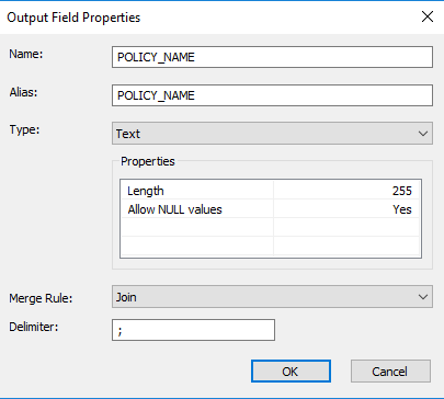

    5. For the attributes you want to transfer to the Polygons from the Point, in the field map right click each field and access its properties.  Change the following in the Output Field Properties:
      1. Make sure to change the field Type is set to Text if it not Text already
      2. Change the field Length to 255 characters (possibly more if the tool fails because the output field is too small and you are outputting to a geodatabase)
      3. Change the field Merge Rule to Join
      4. Set the Delimiter to a character or set characters that are not contained in the original attributes, like a semicolon (";").

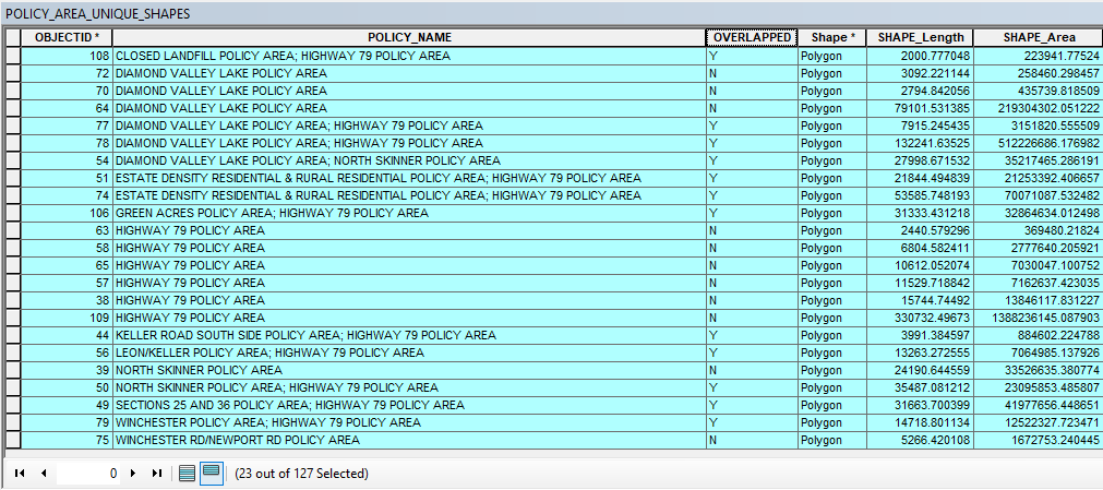

  7. The final output features will have the following characteristics:
    1. Features with attributes that do not contain the delimiter character(s) were not overlapping and the attribute is identical to the original feature.  These features can be selected with an SQL expression similar to:
      NOT POLICY_NAME LIKE '%;%'
    2. Features with attributes that contain the delimiter character(s) were originally overlapping, but now are a single feature that has a list of all the attributes of the original overlapping features separated by the delimiter.  These features can be selected with an SQL expression similar to:
    3. Features with Null attributes were not originally features, but they were empty spaces fully enclosed by the original features that can be eliminated or merged into surrounding features if they are slivers.  These features can be selected with an SQL expression similar to:
      POLICY_NAME IS NULL
  8. The features in the picture below with solid fills are just the portions of the original polygons that overlapped.  The features are contiguous without any overlaps and the attributes associated with each portion list all of the overlapping values in a single feature.  They can be symbolized or selected separately and won't cause feature duplication due to overlaps when they are intersected with other feature classes.
