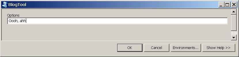

It works like you'd expect:
toolbox
tool
results
Now, if you run it from the command line, despite it not having a .py suffix, you get no error, but it doesn't do anything either:
