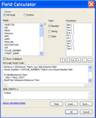

1.       Once the events have been created, add a text field with 25 characters called SIDE_PARITY (parity is the term for even or odd numbering) and calculate it using the Field Calculator  with the following formula:
a.       Parser: VB Script
b.      Show Codeblock: Checked
c.       Prelogic Script Code:
Distance = [Distance] ' Match your Side Distance field
House_Number = [HOUSE_NUMBER] ' Match your House Number field
If IsNull(Distance) Then
  Side = "NULL_DIST"
ElseIf Not IsNumeric(Distance) Then
  Side = "NON_DIST"
ElseIf CDbl(Distance) = 0 Then
  Side = "ON_LINE"
ElseIf CDbl(Distance) > 0 Then
  Side = "LEFT_SIDE"
ElseIf CDbl(Distance) < 0 Then
  Side = "RIGHT_SIDE"
Else
  Side = "CHECK_SIDE"
End If
If IsNull(House_Number) then
  Parity = "NULL_HOUSE"
ElseIf Not IsNumeric(House_Number) then
  Parity = "NON_HOUSE"
ElseIf CLng(House_Number) = 0 Then
  Parity = "ZERO_HOUSE"
ElseIf CLng(House_Number) Mod 2 = 0 Then
  Parity = "EVEN_HOUSE"
ElseIf CLng(House_Number) Mod 2 = 1 Then
  Parity = "ODD_HOUSE"
Else
  Parity = "CHECK_HOUSE"
End If
Output = Side & ", " & Parity
d.      SIDE_PARITY = Output (just enter Output in the expression for the field).
e.      If this is the first time you have done this calculation, save it to a file with the Save button for easy reuse in the future.
f.        Here is a screenshot of how it should look:

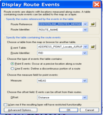

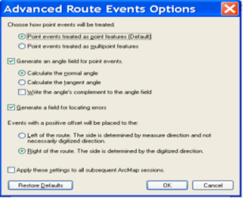

6.   Right click on the validated Address Event table and choose the Make Route Event Layer context menu item to create a point event layer from the event table.  Use the Distance field as the Side Offset.
7.   Click the Advanced Options… button at the bottom left corner of the dialog and set the  paying particular attention to the “Events with a positive offset will be placed to the:” option.

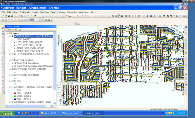

8.   Change the symbology of the layer to the Categories using Unique Values and choose the SIDE_PARITY field as the field to symbolize.  Add all values and make the colors contrast (My preference is to pair Blue and Gold and Red and Green on opposing sides.)  Here is a screen shot of a layer set up:
9.   Make sure the addresses appear to match the expected sides of the street.  If they don’t, open the layer Properties, go to the Source Tab, press the Set Data Source… button, press the Advanced Options… button and change the “Events with a positive offset will be placed to the:” option.
10.   This should reveal the pattern of addressing that is typical for the East/West roadways and the North/South roadways.  In this area East/West roadways are predominantly Left and Odd and Right and Even, while North/South roadways are Left and Even and Right and Odd house numbers.

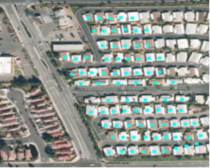

1.       Here is my address layer after using a definition query to filter the layer to only show addresses that have Unit numbers.
2.       Each cluster that duplicates the same House Number address will have to be reduced to a single house number point location using a new field (which I chose to call REMOVE_UNITS) that will flag the unit points that should not be used for creating ranges.
3.       Here is an example of one set of duplicated house numbers due to unitization with the units to be removed shown selected in blue and the unit that will remain shown in red (next to the road below the entry driveway).
4.       In some cases the measure value of the remaining cluster point may need to be adjusted to a new pseudo-position relative to the street they are addressed on if their real position is not well placed for the overall range or where the mailing address is really located.

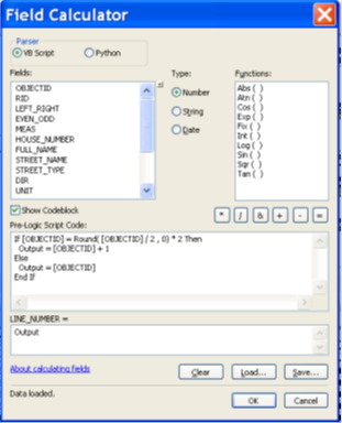

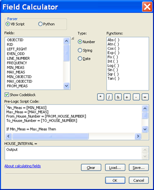

4.       Add a long field called LINE_NUMBER to the summary table and calculate its value to be:
If [OBJECTID] = Round( [OBJECTID] / 2 , 0) * 2 Then
  Output = [OBJECTID] + 1
Else
  Output = [OBJECTID]
End If
d.      LINE_NUMBER = Output (Only type the word Output in the expression text box)
e.      Here is a screen shot of how the field calculator set up should look:

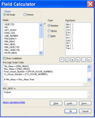

15.   Add a text field with 20 characters called ASC_DESC to the table.
16.   Calculate the ASC_DESC field to be equal to the following:
Min_Meas = [MIN_MEAS]
Max_Meas = [MAX_MEAS]
From_House_Number = [FROM_HOUSE_NUMBER]
To_House_Number = [TO_HOUSE_NUMBER]
If Min_Meas = Max_Meas Then
  Output = "Same Measure"
ElseIf To_House_Number > From_House_Number Then
  Output = "Ascending"
ElseIf To_House_Number < From_House_Number  Then
  Output = "Descending"
ElseIf To_House_Number = From_House_Number Then
  Output = "Same House Number"
Else
  Output = ""
End If
d.      ASC_DESC = Output (only type the word Output in the expression text box).
e.      Here is a screenshot of how the calculation looks:

18.   Add a double field named HOUSE_INTERVAL to the line event table.
19.   Calculate the HOUSE_INTERVAL field to be equal to the following:
  Output = 0
ElseIf Not IsNull(To_House_Number) and Not IsNull(From_House_Number) and (To_House_Number - From_House_Number) <> 0 Then
  Output = (Max_Meas - Min_Meas) / (To_House_Number - From_House_Number)
Else
  Output = 0
End If
d.      HOUSE_INTERVAL = Output (Just type the word Output in the expression text box).
e.      Here is how the calculation looks:

Evaluating the Address Line Output for Unexpected Patterns

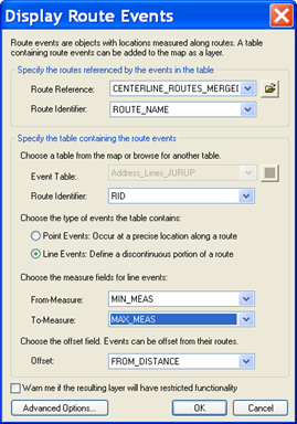

1.       Right click the Address_Lines table in the Source tab of the Table of Contents and choose the Display Route Events… context menu item.
2.       Set the layer to be a Line Event layer with the MIN_MEAS and MAX_MEAS fields being the From and To Measure fields respectively.  Assign either the FROM_DISTANCE or TO_DISTANCE Field as the Side Offset field.
3.       Here is how the dialog looked when I configured it for my specific data:
4.       Press the OK button.
5.       If the lines do not align with the Address points, open the layer Properties, go to the Source Tab, press the Set Data Source… button, press the Advanced Options… button and change the “Events with a positive offset will be placed to the:” option.

6.       Start an edit session on the Add_Right_Even table workspace.
7.       Copy paste the lowest FROM_HOUSE_NUMBER of the Address_Lines selection to the MIN_FROM_HOUSE_NUMBER of the Add_Right_Even table on the matching RID values.
8.       Recalculate the HOUSE_INTERVAL of the Add_Right_Even table using the formula saved in
9.       Save the edits when all are finished.

1.       Use the Overlay Route Events tool the Linear Referencing Tools toolbox with the following settings:
a.       In_Table:  CL_Ends_Locate
b.      In_Event_Properties:  RID, POINT, END_MEAS
c.       Overlay_Table:  Address_Lines
d.      Overlay_Event_Properties: RID, LINE, MIN_MEAS, MAX_MEAS
e.      Overlay_Type: Intersect
f.        Out_Table:  CL_Ends_Add_Lines
g.       Out_Event_Properties: Default settings (rid, POINT, meas)
h.      Fields: Keep all fields
i.         Build_Index: Index

11.       You can use the Display Route Events context menu item on the output to create a point event layer showing the centerline segment end points.  If you calculated a FROM_DISTANCE and TO_DISTANCE field in your Address lines, use that value for the side offset.  The layer coloring can import the settings of the Address points
8.       Here is how my particular layer looked:

4.       Create a line layer from the CL_Lines table using the Display Route Events and put the following definition query on it to only show the fully addressed lines:
a.       "L_F_ADD_LONG" > -1 AND "L_T_ADD_LONG" > -1 AND "R_F_ADD_LONG" > -1 AND "R_T_ADD_LONG" > -1
5.       Create another line layer from the CL_Lines table using the Display Route Events and put the following definition query on it to only show the partially addressed lines:
a.       ("L_F_ADD_LONG" > -1 OR "L_T_ADD_LONG" > -1 OR "R_F_ADD_LONG" > -1 OR "R_T_ADD_LONG" > -1) AND NOT ("L_F_ADD_LONG" > -1 AND "L_T_ADD_LONG" > -1 AND "R_F_ADD_LONG" > -1 AND "R_T_ADD_LONG" > -1)
6.       Rename the two layers to make it clear what they are showing.
7.       Make the two line event layers distinct colors from each other and adjust the symbology settings to make them stand out.
8.       Here is the result of how I displayed my two event layers with dark red lines being fully addressed centerlines and pink lines being partially addressed centerlines.  The grey lines have no address and are the original centerlines used as background layer.

11.   Calculate the L_F_ADD field with the following calculation:
c.       Pre-Logic Script Code:
Min_Meas = [CL_LINES.MIN_MEAS]
Asc_Desc = [Add_Left_Even.ASC_DESC]
Min_Min_Meas = [Add_Left_Even.MIN_FROM_MEAS]
Max_Max_Meas = [Add_Left_Even.MAX_TO_MEAS]
House_Interval = [Add_Left_Even.HOUSE_INTERVAL]
Min_From_House_Number = [Add_Left_Even.MIN_FROM_HOUSE_NUMBER]
Max_To_House_Number = [Add_Left_Even.MAX_TO_HOUSE_NUMBER]
Max_From_House_Number = [Add_Left_Even.MAX_FROM_HOUSE_NUMBER]
Min_To_House_Number = [Add_Left_Even.MIN_TO_HOUSE_NUMBER]
If Asc_Desc = "Ascending" AND Min_Meas < Min_Min_Meas Then
  Raw = (Min_Meas - Min_Min_Meas) / House_Interval + Min_From_House_Number
  Output = Round((Min_Meas - Min_Min_Meas) / House_Interval/2, 0) * 2 + Min_From_House_Number
  If Output < Raw Then Output = Output + 2
ElseIf Asc_Desc = "Ascending" AND Min_Meas > Max_Max_Meas Then
  Raw = (Min_Meas - Max_Max_Meas) / House_Interval + Max_To_House_Number
  Output = Round((Min_Meas - Max_Max_Meas) / House_Interval/2, 0) * 2 + Max_To_House_Number
ElseIf Asc_Desc = "Descending" AND Min_Meas < Min_Min_Meas Then
  Raw = (Min_Meas - Min_Min_Meas) / House_Interval + Max_From_House_Number
  Output = Round((Min_Meas - Min_Min_Meas) / House_Interval/2, 0) * 2 + Max_From_House_Number
  If Output > Raw Then Output = Output - 2
ElseIf Asc_Desc = "Descending" AND Min_Meas > Max_Max_Meas Then
  Raw = (Min_Meas - Max_Max_Meas) / House_Interval + Min_To_House_Number
  Output = Round((Min_Meas - Max_Max_Meas) / House_Interval/2, 0) * 2 + Min_To_House_Number
Else
  Output = -1
End If
d.      L_F_ADD = Output (Just type the word Output in the expression text box)

21.   This shows the result for my data in the 2 layers that were set up in step 7 of this section:
