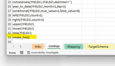

You can also manually add the function name to the hidden lookup sheet.
Right click the tabs and select unhide
select -Lookup-
scroll to the bottom and add your function, in my example, I added create_foo()
