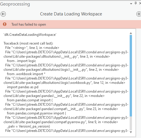

If it helps diagnose the issue though, when I instead have dltsolutions v 2.7.0 installed, I am able to open the project normally, and the Data Loading Tools toolbox shows up in the Geoprocessing pane.  However, when I try and open any of the tools from that toolbox, I get an error message, "Tool has failed to open".
Upon opening a project, the first DLT Tool I try opening has the following details for the error.
If I then close that tool and open a different tool from DLT toolbox, I also get "Tool has failed to open", but it has different details.
The different error messages appear in that order, regardless of which DLT tool is opened first and second.

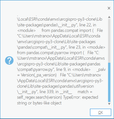

MichaelStranovsky
This is what is happening after starting up ArcGIS Pro
TedHoward2
Yes same problem. It has to do with the latest pandas package being incompatible with the python environment that ships with Pro 2.8. To resolve please try installing the latest build of Data Loading tools from the esri conda channel. A new build became available yesterday.

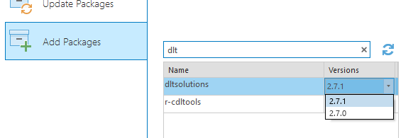

Just wondering, what version is the new one and how do you get access to it.  When I go to the package manager, all it lists are 2.7.0 & 2.7.1, which both have issues (though the errors show differently, as noted in my comment above).
TedHoward2
If you are attempting to install via the python backstage in Pro is will still be version 2.7.1. Again this is a conda issue so only the build number for the package has been incremented. The important part here is that pandas cannot be on version 1.3 or higher in your environment.
