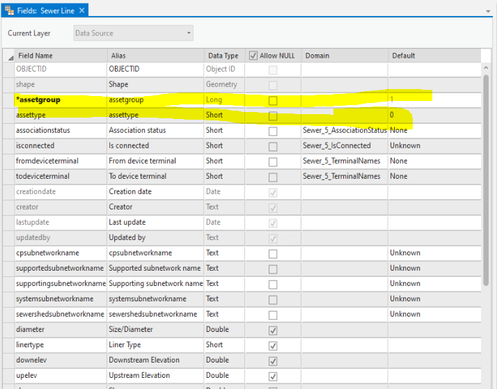

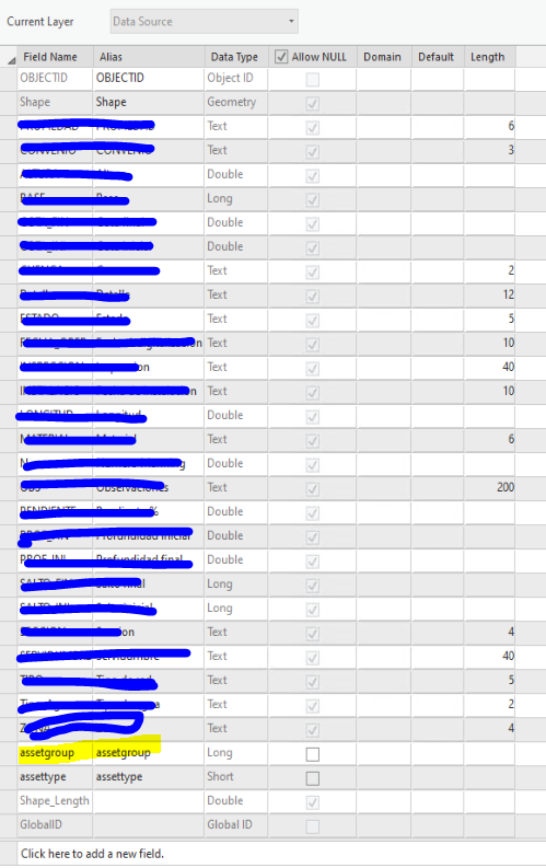

it seems that the problem is in the assetgroup field, it has no null evaluators.

Thanks for help, part of what you say I have inferred by reviewing the code of the etl.py file, line 314. I tried to export the feature class temp that creates a field "assetgroup : TEMP" and I managed to reproduce the isolated error.

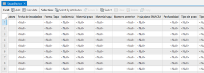

geopamplona
Hello @TedHoward2
My colleagues have implemented workflow you mentioned, however they have noticed that it is failing and the data is not migrating.
I have checked it again and indeed, the command finishes correctly but the data is not loaded in the AssetPackage.
The flow I have followed is as follows: I do Change Spatial Reference and then Execute Data Load.
All values in all fields are null.
Have you tried the same flow and were you able to migrate the data?
Thank you!
TedHoward2
When I run Execute Data Load using your sample data (after running Change Spatial Reference), the Asset Group field gets populated correctly. A number of other fields have values specifically because they have default values assigned. The rest of the fields are null because nothing else is mapped in the Mapping workbook which is expected.

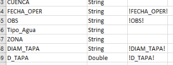

Hi,
I have noticed that Create Data Load Workspace tool does not join fields that have exactly same name in my case.
Previously, in previous versions of DLT, this behavior occurred according to documentation, whereby fields that have same name are migrated.
In this case, fields have same name and tool is not recognizing them automatically.

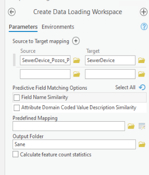

I am creating the Data Loading Workspace in this way, with default arguments (to maintain compatibility over previous versions):

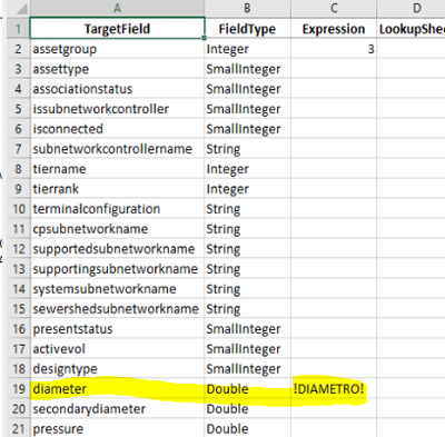

If I enable Field Name Similarity, it configures fields to migrate, but with errors, there are not only exact matches, for example Diameter and Diametro, it joins them, but it is not correct; in rest of the cases it is the result I expect.
As a conclusion, DLT has a different behavior between the last two versions. In the case of Arcgis PRO 2.9 I am a captive customer of the latest version of DLT, which does not work as expected.
