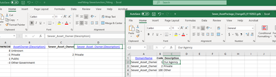

Maybe I am missing this part in the instructions, but what if I have the following:
can I change the Our Agency value to be "public" so that it matches what we currently have? Can I add in additional values to the asset package tables? or is this a no-no??
AlixVezina
Hi @VanessaSimps , you would need to add the value to your target database schema (your asset package), and update the appropriate target workbooks to reflect that change (or recreate all the workbooks).
Then you can assign that value as the new default value for your target features either by hard-coding the value for that field or using the lookup-columns as shown here https://youtu.be/c4x_anYd7UY?t=716
Also note that the domain workbooks (found in the Domains folder) are purely for reference and they do not affect how data is loaded.
