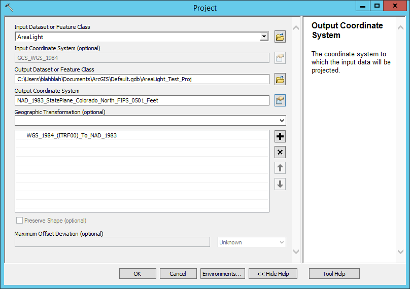

I got some shapefiles from a local energy utility company. They are in GCS_WGS_1984. I brought them into ArcMap (10.3) and performed a Project to get them into my projection (NAD_1983_SPC CO-N). This erased all the features. Never had this happen before.  The original shapefile is intact, but the newly created file geodatabase feature class has zero features. Zero features, zero attributes. It brought over the fields & field names, but there's not a shred of data. I've tried doing it in ArcMap, ArcCatalog, shapefile --> shapefile, and shapefile --> file geodatabase feature class. What am I missing?

I've put it into three different geodatabases. I've gone shapefile to projected shapefile. I've gone shapefile to geodatabase. Just made a fresh geodatabase. I'm even getting an error saying that it's generating empty outputs.

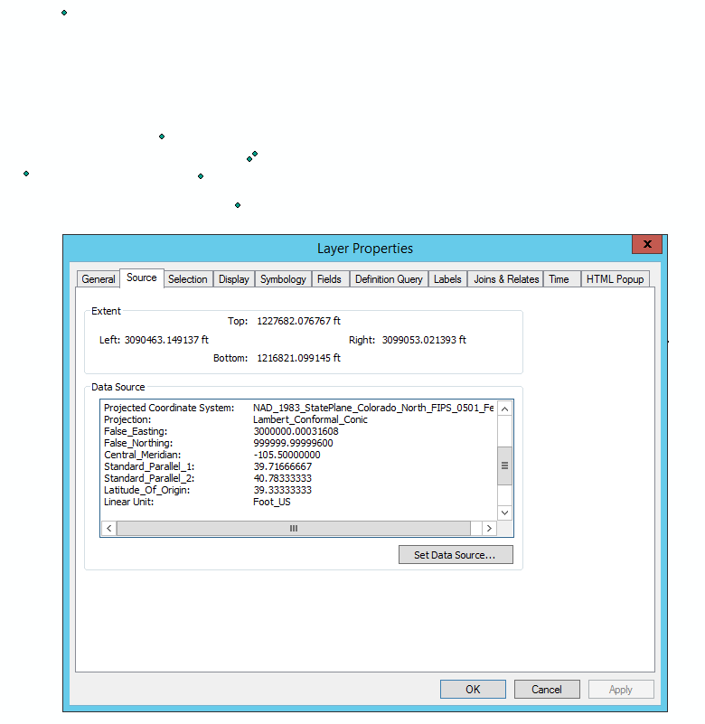

ChrisSmith7
Honored Contributor
The reprojection worked well for me:
