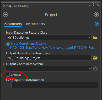

In ArcGIS Pro, you can transform your 3D vector and raster data with Project and Project Raster tools, by checking Vertical checkbox in the tool. The vertical checkbox becomes available when you add 3D data to the tool and set horizontal and vertical output coordinate systems.
