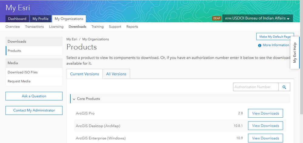

Additional Coordinate System Data install can be downloaded from My Esri download page. It does not require additional license, just access to your organizational My Esri account. This graphic might help you located the install on the side. The thread includes some information on the installs and here is a little bit extra information. I hope this helps.

BIA__Office_of_Trust_ServicesD
Thanks for you help.  Referencing your attached graphic I cannot see a 'Data and Content' link from my organizations download page.
BojanŠavrič
I am not sure. Do you have more dropdown menus listed under "Core Products" in the main window? If not, I would suggest you to contact your administrator and ask them where you can find ArcGIS Coordinate System Data installs. I hope this help...
