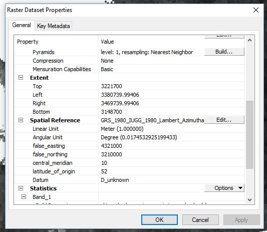

What Melita is saying that that you should have only changed the underlying GCS of your existing coordinate system,
scoot down using the arrow to the bottom half of the edit window. (picture 2 below).

This is the original data:

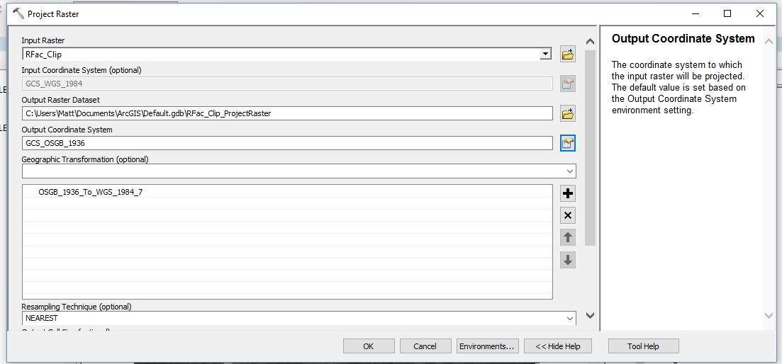

Then I used Project Raster > OSGB to WGS84:
However i'm still getting this error:
Thanks for the help
