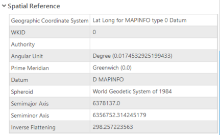

I have been provided it a shapefile from MapInfo. When I bring the shapefile into ArcGIS Pro 2.5 the polygons are c.50m off where they should be located. How do I fix this?
