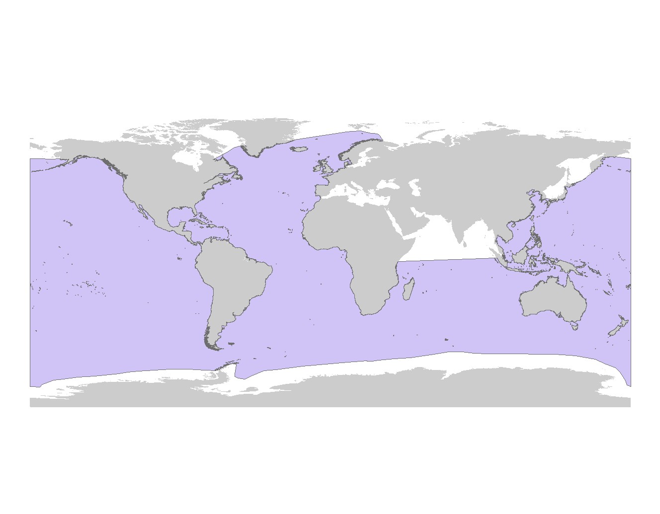

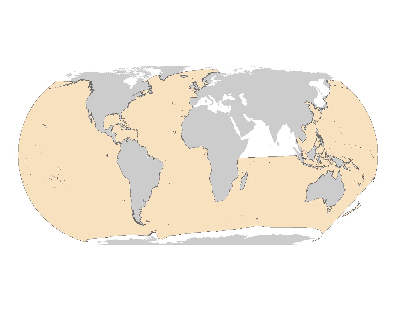

ClintonJenkins
Deactivated User
Below are examples. The original purple layer is geographic, the other two are EckertIV and Mollweide. Notice the area around New Zealand.
MelitaKennedy
Esri Notable Contributor
Try densifying the polygons before projecting them. Because it's happening on edges that are curved in the target CRS, I think you have "two-point lines" in the problem areas. ArcGIS doesn't automatically densify when reprojecting data.
You might also run the check geometry tool to see if it finds anything.
Melita
ClintonJenkins
Deactivated User
Aha! Check geometry didn't find anything, but densify seems to work. I'm not sure how practical it will be if it means I have to add lots of extra vertices, since that would make the file bigger, but this does look to be the fundamental problem. Thanks!
