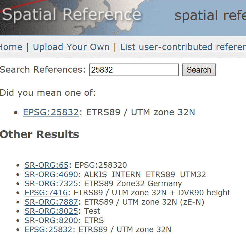

Yet, when you go to the spatial ref site and query by 25832.
you get a number of other options... Do any match esri's?
Carolinvon_Groote
It seems that ETRS: SR-ORG Projection -- Spatial Reference  matches the Esri WKT style. But I can't address this url directly while transforming with e.g. ogr2ogr (at least not when I want to transfrom with an additional NTv2 grid). As far as I understand it I have to transform in 2 steps in order to get an esri readable prj file.
