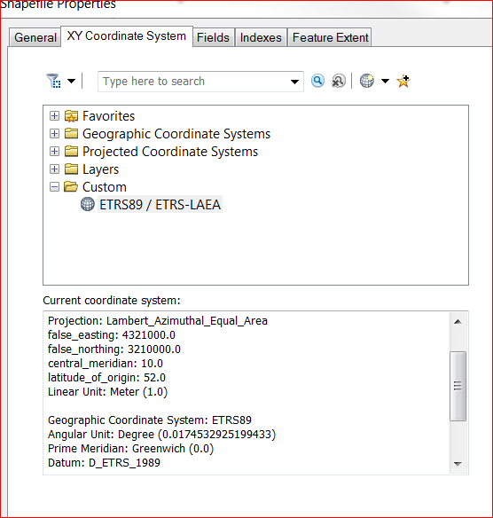

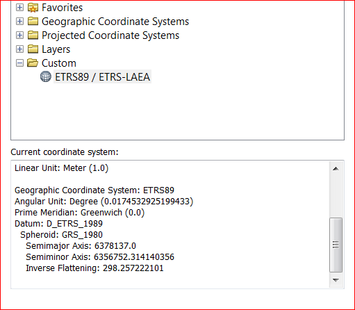

JulieNacos
Hi Melita,
I have a similiar question as I am using Corine's Version 17 (12/2013) Landcover 2006 Vector data - data downloaded in a zipfile from this link here: Corine Land Cover 2006 seamless vector data — European Environment Agency.
Below this text I have enclosed 2 screenshots of the Corine properties: ETRS89/ETRS-LAEA.
What would be the best way to transform and project this data for the most accurate alignment in WGS1984_UTM34N?
Thank you, Julie
MelitaKennedy
Esri Notable Contributor
Hi Julie,
Either use the Project or Project Raster tool. In the tool for the output coordinate system, you should be able to type in the well-known ID of the UTM zone, 32634, or browse to projected coordinate systems, UTM, WGS 1984 (North). For the geographic transformation, use ETRS_1989_To_WGS_1984.
Melita
