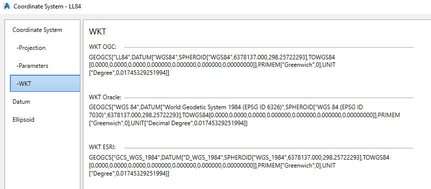

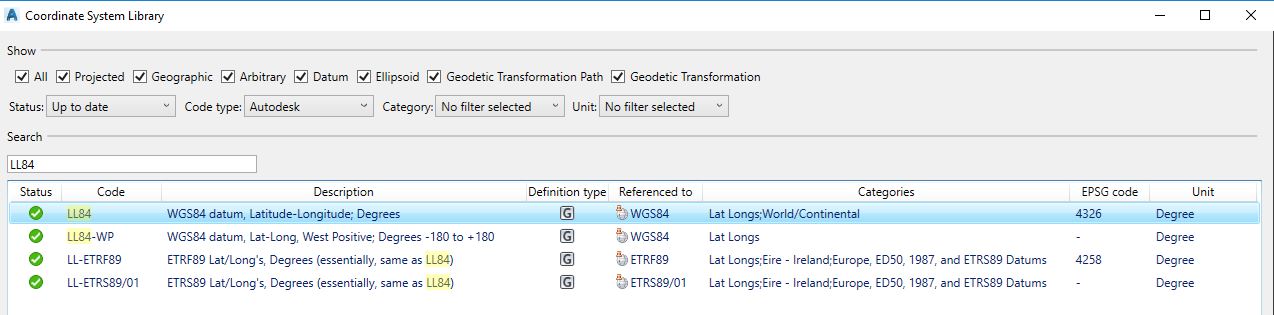

ChuckTurlington
Dan,
Thanks again for your help.  I did find the correct datum but I notice that the flattening is not the same as what Autodesk reports, see attached screen shots.  However, the EPSG code matches and the imported aerial imagery appears to align with the site correctly.  For my own understanding, is there a way I can search in ArcMap for the EPSG code when trying to match between Autocad or MicroStation to ESRI AcrMap?
