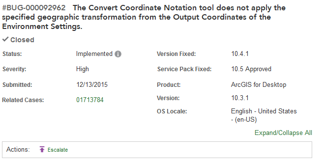

This might not have anything to do with it, but just in case..
BTW - I had tested in 10.2.2 and 10.3.x, and I suspect the issue was around for a few more versions.  The description is a little misleading, but basically, things were truncating and/or not being appried.  Mine was in Convert Coordinate Notation, so like I said, might not apply.
