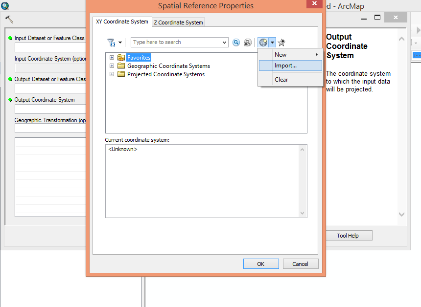

How do you use the “Project” tool to create a new layer in the same coordinate system as the other layers?

Thank you. I will give that a try and let you know. Basically, I have three layers (census tract, census block and boundary) that are in different geographic coordinate systems and all of the layers must be in the same coordinate system in order use the Flood Information Tool in Hazus.

use Import while using Project tool and select the output coordinate system. and browse the other layer that you want to project to.

Thank you Abdullah Anter. I am unable to find the output coordinate system using the Import function in the Project Tool. But, I am able to search for it (WGS_1984_UTM_Zone_10N) in the Spatial Properties Box and select it.  The problem is I can't find the census tract, census block and boundary layers that I want to project to WGS_1984_UTM_Zone_10N because they are coming from an SQL Server. I believe that means they are accessing online data types? I may be mistaken.
