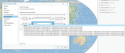

Yes, we do support conversion of heights between CGVD28 and CGVD 2013 and CGVD 2013 (CGG2013a). You can use Project tool with Vertical option turned on, or you can do it on-the-fly in ArcGIS Pro.
Please note, you will need to install supplementary coordinate system files, which include CGG2013 and CGG2013a geoid models and other conversion grid files.

Please note that we added support for vertical transformations between CGVD28 and CGVD2013 in ArcGIS Pro 2.9. You will need to install supplementary coordinate system files, which include CGG2013 and CGG2013a geoid models and other conversion grid files.
