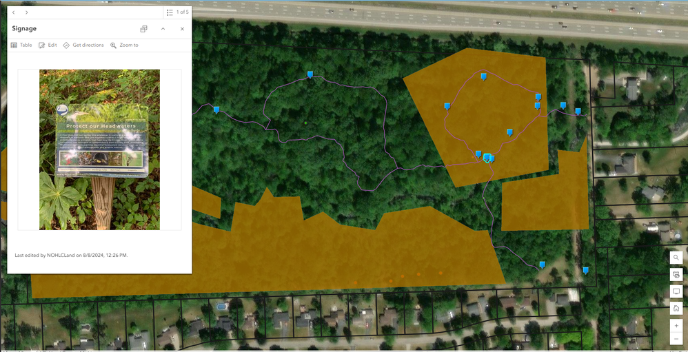

Before going out to Nels Kimball Sanctuary, we created new point, line, and polygon feature layers on ArcGIS Online that would serve as containers for the new attributes recorded on the field. Once out on the property, we used ArcGIS Field Maps to collect the locations of signage, parking areas, and trail entrances as point features. We utilized the photo and text description entries if needed, taking notes on amenity conditions and highlighting any need for maintenance. We recorded all of the trail paths as line features using the streaming tool. During this visit, we did not find a need to add to the pre-existing polygon features on the property, which indicate areas of invasive growth or other concerns.
Screenshot (32).pngFigure 1. Recording photos and descriptions of signage and other property features

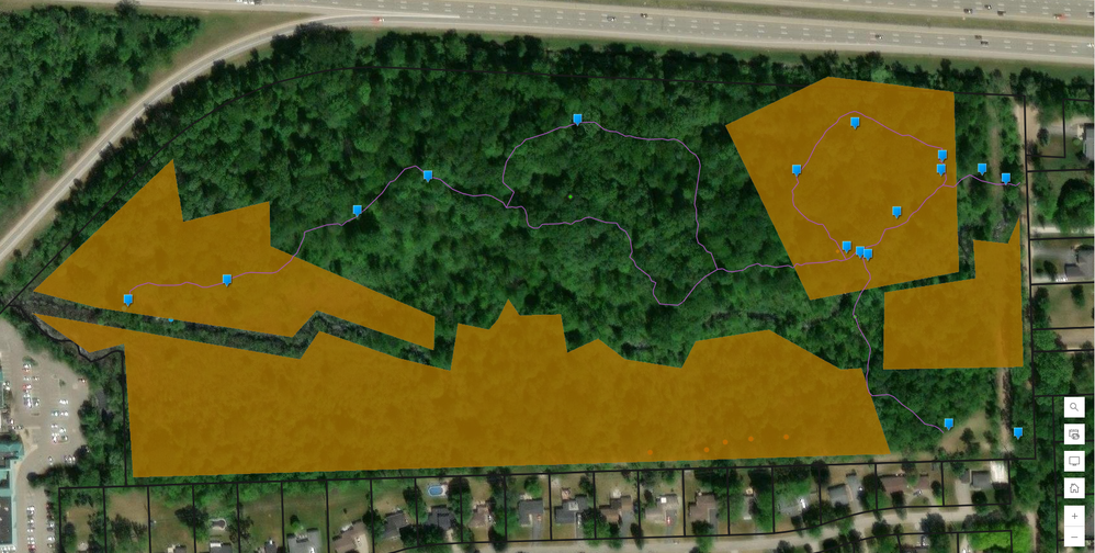

After the field data collection, we opened a copy of the recorded attributes on ArcGIS Pro. Figure 2 shows all of Nels Kimball Sanctuary’s unrefined point, line, and polygon features, including the trails and access points recorded for the trail map:
Figure 2. Collective unedited geodata of Nels Kimball Sanctuary

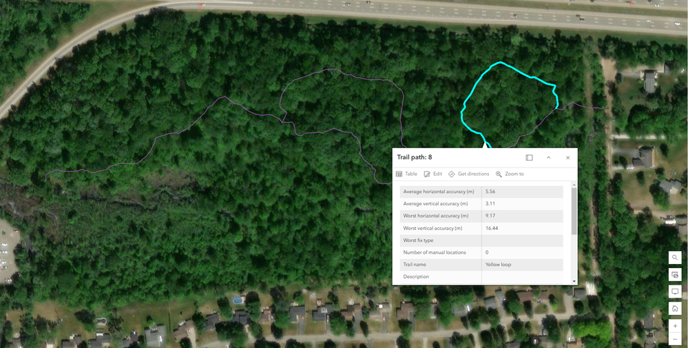

Because we wanted to create an interactive web map, we used Configure Pop-ups to edit the type of information that shows up when viewers click on each feature on the map. Figure 3a shows the default pop-up window for the Yellow Loop, and Figure 3b shows the same pop-up after edits were made to improve its appearance and include relevant information on the trail.

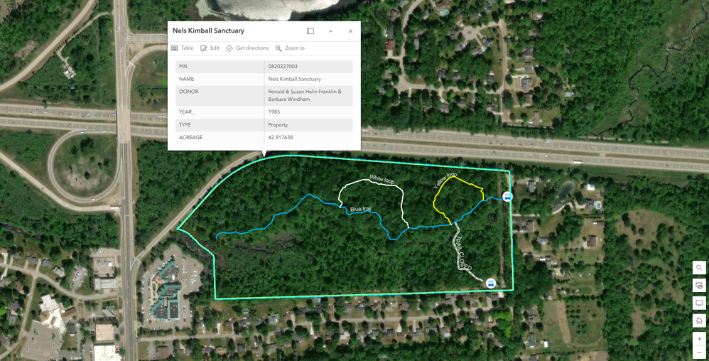

Once edits on ArcGIS Pro were complete, we published a copy of the refined data layers and uploaded the map to ArcGIS Online using Save Web Map. Finally, we confirmed that the web map is accessible to everyone under the web map’s settings in ArcGIS Online.

Figure 3a. Yellow loop pop-up before editing
Figure 4. Final web map for Nels Kimball Sanctuary and the property pop-up window
View the web map of Nels Kimball Sanctuary here
