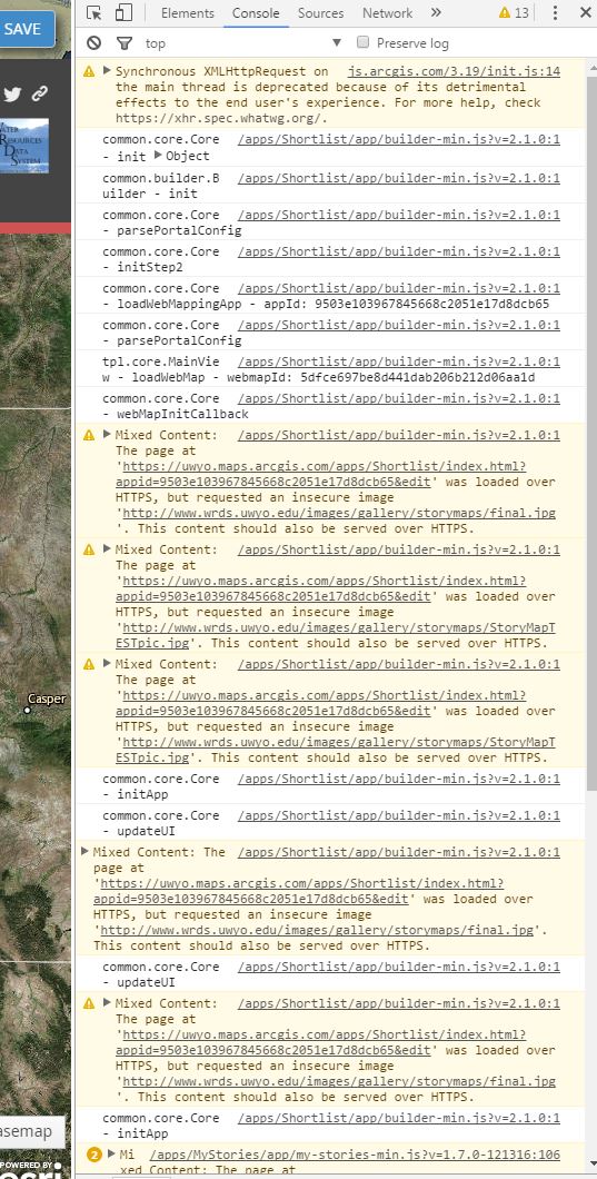

RosemaryHatch1
Hi Mark,
There are errors in the console, but I’m not a developer, and can’t seem to figure out what they mean/if any are actually relevant to the issues I’m having. I’m attaching a screenshot of the errors.
Thanks again for your help!
Rosemary
