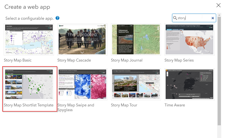

RaoulComaduran2
Greetings,
I have worked with Github source code for the last few days, added the code to my web server where portal is installed, configured the index.html with my app id after adding and other configurations mentioned here (https://medium.com/story-maps-developers-corner/an-introduction-to-hosting-your-own-story-map-e24501... ; GitHub - Esri/storymap-shortlist: The Shortlist story map application template by Esri ) But at the end of the day, all i get is this: https://egis.dla-apphub.com/Shortlist/index.html .
It just spins its wheels. I am more or less, looking to just share out the template so that users in our Portal site can build out their own version of the ShortList Story Map. What am i missing? I have shared it with my web app gallery and looks ready to roll but the template there won't open the builder to begin building the actual short listshort list template
What am i missing? Do i need to insert a portal based sharing url in the config options? Do i need to insert updated parth for the pathJSAPI?
Any help is appreciated.
